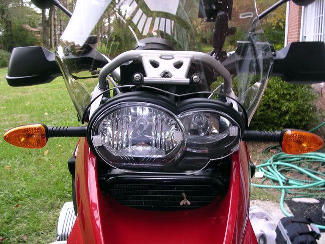

For $2.50 in Lexan, and $1 in Duel Lock I now have a decent looking cover for my headlight, too late for a small rock chip, but hopefully good for protection.
A very lightly used CeeBaileys +2 +2 screen. Seems to add protection, but no better for buffeting, though the stock was pretty good too.
GPS Mount with $1 home made sun screen. I used a plastic folder from Staples and a few inches of black velcro. It works better than the aftermarket ones because it is twice as deep, and blocks more sun.

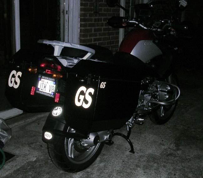

Home meade "GS" reflective stickers for the back and side. I made them with 3M reflective tape sheets for $10.
You can barely see them here. They work great, so I am told.
I removed the rear facing reflectors and added a duel helmet lock kit I got from here for $20. I am going to add the reflectors to the sides of the Jesse bags.

JimVonBaden wrote:For $250 in Lexan, and $1 in Duel Lock I now have a decent looking cover for my headlight, too late for a small rock chip, but hopefully good for protection
Should that say $2.50? I think you can buy a new headlight assy for $250.
Got any of the lexan scraps left? Where'd you get it?

Fixed, thanks! I do, but the sheet was only 8" X 10". I got it at Lowes!

Sweet. Where did you buy the 3M reflective panels?

BreadMan wrote:Sweet. Where did you buy the 3M reflective panels?
Mortons had a sheet for $10, but you can get it online almost anywhere.
I used PowerPoint to get the font and size right.

Where'd you get the dual lock for the headlight? I want some to mount the FRS radio on the dash where I can see it. I haven't found anything nearly strong enough for that at HD (or anywhere else). What I want is the stuff they give out with an EasyPass.

guitardad wrote:Where'd you get the dual lock for the headlight? I want some to mount the FRS radio on the dash where I can see it. I haven't found anything nearly strong enough for that at HD (or anywhere else). What I want is the stuff they give out with an EasyPass.
You can get it at Target in the hardware section for $2.50 for 10", both sides are the same, and it really sticks. Worked great on my Laminar lip, and you know how much force is on that!
